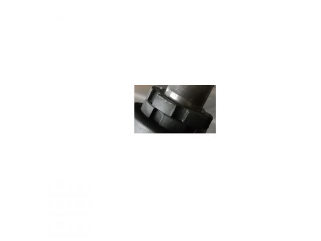

    Anyhow, to the next question: How the *&^%(^%^&%*& do you take the bottom part of the triple tree off the yolk?? It looks like two crown nuts threaded onto each other at the top... if you unthread them, it looks like it'll drop out from the bottom (maybe with a little help lol). The problem is that I can't get the nuts to turn, at all. I've soaked them in oil, beat them with a rubber mallet and a chisel trying to use the crowns to turn them.... nothing. They just won't turn, either direction. I'd leave them there, but the steeting bearings REALLY need replaced, so the part has to go. Anyone know a secret that I can't figure out??? My garage has heard a few things that I'm not so proud of, and I'm shocked I haven't busted something launching objects across the room.... help. lol (I took pics of that, too, if it would help to see, but I imagine someone on here has dealt with something similar and knows what I'm talking about)!

    Anyhow, real reason for posting is that I'm still hoping to get some advice about what to do with that triple-tree. Again, the steering bearings are so bad, it's gotta come out, but I can't seem to get anywhere on it.... That's actually the first thing I have to do before I can re-assemble her into a rolling chasis. After that, it's just gonna be body work, wiring, and fuel line.

    Throw a pic up here of your problem...'tho after the beating you gave them , a set of easy outs is probably the way to go.

    this is a pretty good pic of the top of the yolk; I think the crown nuts come off separately, and the bottom of the tree should slide out from the bottom of the yolk??? I haven't torn anything up, didn't want to damage it, 'cause I'd like to replace the bearings and use the same tree, but I'm about the take a grinding wheel to it!!!!
    • 4 posts
    August 19, 2010 12:45 PM PDT
    (sorry, it was a better pic, but I had to crop it to make it load!!!!)

    Shop class call to order......... Bottom nut sets the bearing preload. Top nut locks the bottom from turning by Jamming the nuts tight against each other. First a spanner wrench (adjustable or rigid "Hook") is the best way to move them. Next best is a square faced "Brass" punch to fit the width of the notch in the nut. They are right hand threads so righty tight (clockwise)--lefty loose (counterclockwise). Mark with a felt marker first for later assembly to be sure they are tight. Strike firmly the spanner or punch with a large heavy hammer to loosen the TOP nut only. After the top nut is removed, then remove the bottom nut. Failure to loosen Jam fit will most generally cause thread damage. Too small of a hammer or failure to apply enough force (shock) to loosen the nut can also result in a peenning damage to the nut. That is also why a Deadblow or Softface hammer will not work. After the two nuts are removed then use thr soft or dead blow hammer to remove the top plate. The nut left on the bearing shaft threads if in full contact will protect the threads of the nut and shaft. It can also prevent black and blue toes if it lets go quickly. Strike the shaft square and sharply. An oak or hard wood block would work with a hard hammer also. If they have been in the weather then a good soak of liquid wrench or penetration oil and soak time will help prevent thread damage. They are usually a fine thread and can be damaged sometimes very easily. Best of luck and keep your fingers protected..

    Wow thanks for the detailed instructions there! (sounds like you've maybe done that once or twice!) Also sounds like a story of needing the right tools for the job, I'll have to go locate a spanner, and a square punch. I was using a rubber mallet and chisel, and got NOWHERE in record time. Thanks again, I'll post when I have the right tools and get the thing out.
