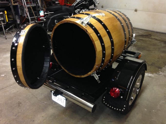

    I finished my homemade trailer this past winter. Now, I'm doing some test runs with it. It still fish tails sometimes over 60mph. I think it's a weight issue. The barrel was empty and only a few bottles of water and some ice in the cooler.  I built it considering the cooler will be packed with water, beer and ice. I need to pack it out like I'm going to Sturgis and then test it. If all else fails, I can move the axles back a few inches.

    Very nice job.  You could probably make some money selling them.

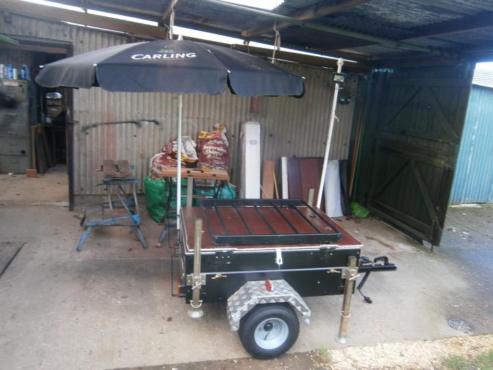

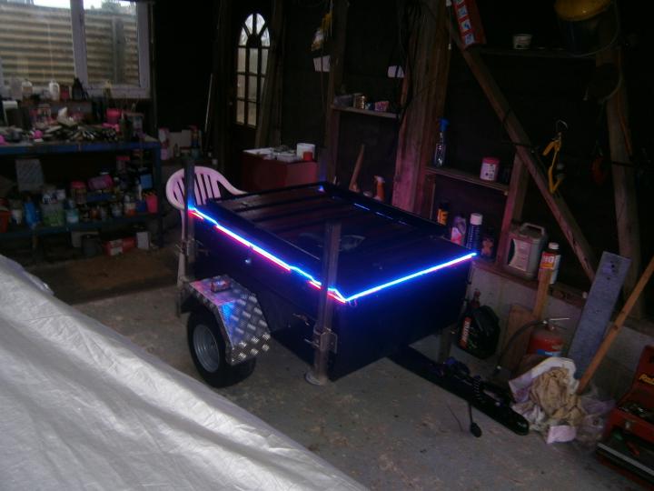

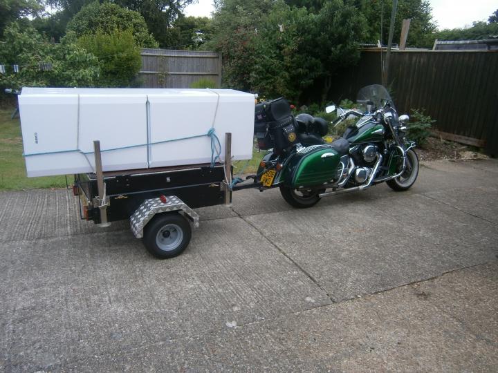

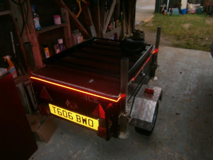

    • 7 posts
    July 11, 2016 3:18 PM PDT
    • 7 posts
    July 11, 2016 3:31 PM PDT
    • 7 posts
    July 24, 2016 12:05 PM PDT
    Its handy for carrying stuff too.

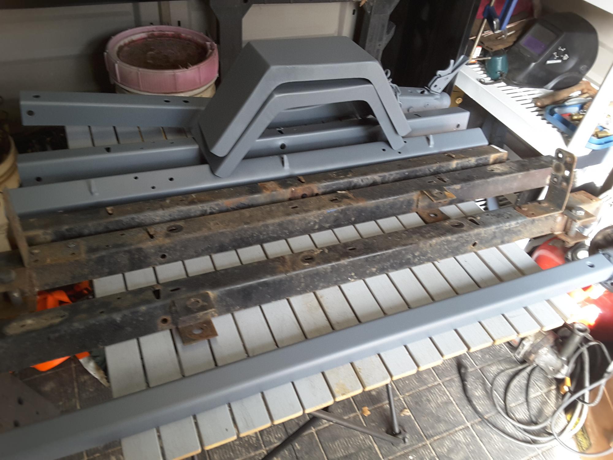

    • 59 posts
    November 10, 2016 11:17 AM PST
    Since this trailer grosses out at #700 anyway, the leaf springs should do fine.  Besides, I already have these.  Here are a couple pics of my trailer.  I have it disassembled and am in the process of stripping it to bare metal and repainting.  A thinking of matthe black for all metal parts and OD green for most of the rest with black WWII style markings.
