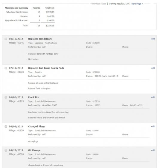

     Snakechrmr,, you know we have a real nice feature here on CycleFish to track oil changes and all maintenance... it is called Service Tracker and in your Garage.  I lets you record and view all maintenance on your bike.  Even keeps a running total of cost by category.
    To start using the Garage and Service Tracker feature, go to your profile and click Manage My Garage under your picture.
    For a quick demo on how the Garage and Service Tracker work go here... http://www.cyclefish.com/tutorials//garage-demo-3.html />
    Here is a screen shot of my Service Record from Service Tracker....
    Now you tell me!
    But thanks I'll check it out for more ideas,
    snake
