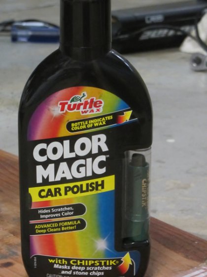

    Anyone who has the flat black lower case on their motor (like me) knows that after a while it just doesn't look jet-black anymore.  It gets kind of dingy looking from the sun, crap from the road, overspray from cleaning stuff you use on the crome, etc.   I have tried everything to get it clean and looking new again but it seams like no matter what I cleaned it with, as soon as it dried it looked old and dingy again.
    Well I found something that works... Turtle Wax Colored Polish (black of course).  I normally use this on the rare occassion that I wax my bike because if you get some in the cracks and crevices you can't get out it dries black and not chaulky white like other waxes and polishes.
    I poured a little in a small dish and dipped a tooth brush in and brused the polish into all the black areas of my motor.  I wiped off the excess and the motor looks brand new again... Jet-Black, just like the day I got it.
    Even after getting hot and even rained on, still black as night!!!
