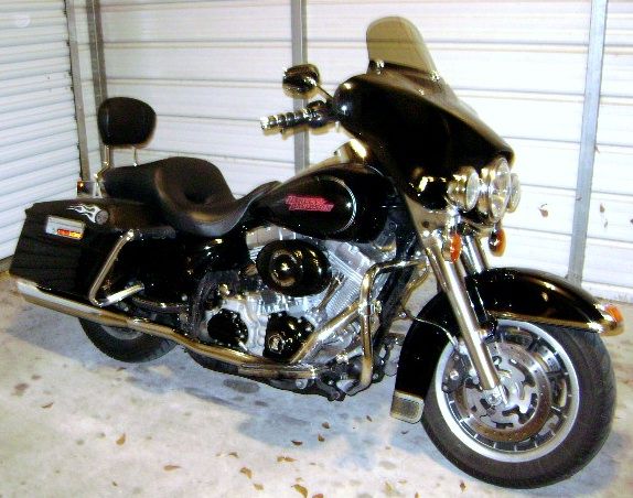

    On my 08 Electra Went with a PCIII Tuner, to manage my Ness Big Sucker Air Intake and Vance and Hines True Duals Giving a Stage 1 Power with A Fuel/Air Ratio around 13.5 rather than the lean 14.7 Stock A/F.. That alone Lowered the Temps considerably as well as increased the HP and Torque about 10%.. Also added a Jagg Vertical 10 Row Oil Cooler for Florida Summer Temps and Run Synthetic Oil as Well even on 90+ Temp days have never seen it over 220 degrees usually around 180-200.. Sacrificed a little MPG but well worth it to me for the extra power and cooling ...

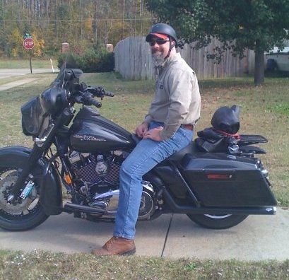

    V&H True Duals Black with the SE High Flow Air Filter and SERT tuned on the Dyno just to get the sound up and add a little power.  For the heat I went ahead and added the Harley Heat Shields and once the 103 kit goes on will also add this http://budsbikerparts.net/ to help with the heat issues.
    You'll never get the lope you are used to hearing with your shovel on the new Twin Cams engines with the stock cam, especially with EFI.  I'm adding a high lift cam from Bob Woods Knight Prowler series cams when the 103 kit goes on to help with trying to bring some of that traditional harley sound back to the bike.

    Definitely like the True Duals in Black but got such a deal on the ones I have will live with it for a while ...  Nice Ride there Hambone ..
