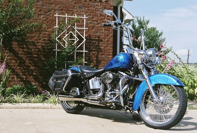

    I had a 21' front on my old Heritage with a single disk.  I ran Lyndall brake pads and had no noticeable  changes in braking.  It will feel different when you first get on and ride but with a few hours of riding it'll feel just like you've always had that large of a front wheel.  I do advise getting the wider 140 or 150 front wheel and tire.  Will make for a much smoother ride all around.
