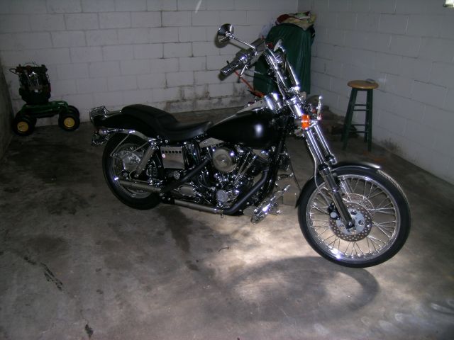

     Putting them on is no sweat. this was my old dyna.
    The post recommended by lucky covers it well

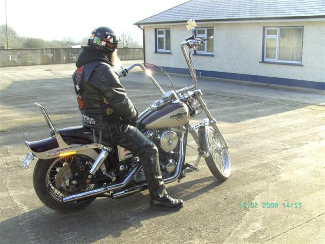

    i got a 2000 Dyna and i just installed 20" apes. ****** beautiful. i bought the bike with 14's then bumped it up to 16's now i got the Paughco monster apes with 20's. once u go apes u never go back. make sure you have your guy drill two holes in the bottom on the bars then drill 2 more holes into the bottom riser. then you plant two good steel bolts into the holes you made on the bottom rise and leave enough bolt exposed so that the top half of the bolts exposed can fit into the two holes you driklled in to your bars. it should be a snug fit. then you're done. tighten the top riser over and clamp down hard. that should save you the anxiety of worryin about bar slippage. some little back and forth sway kis good but at least u wont go doublin up on the highway.. hope this helps.
