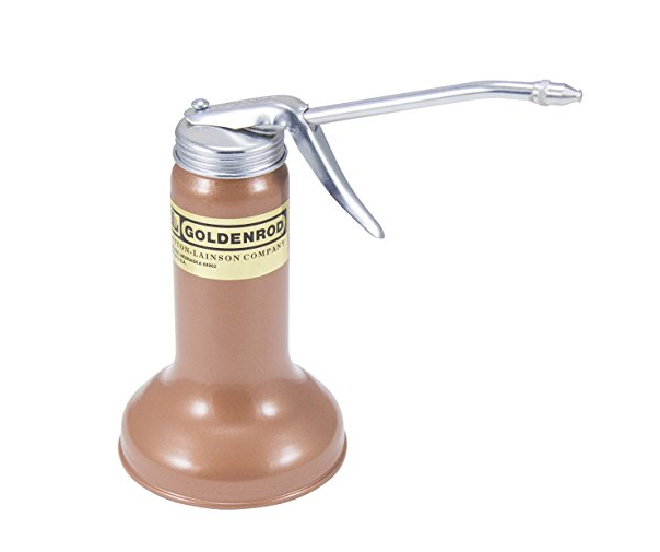

    Probably, I'm going to put my mixture in an old lacquer thinner can, and use a squeeze oilier to apply it on the rusted stuff.
