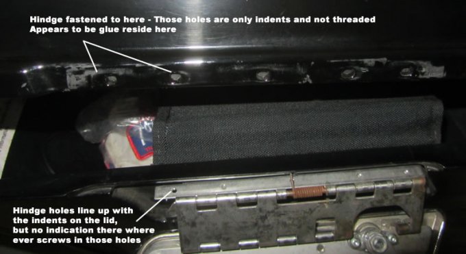

    The hinge has come off my saddle bag - at the lid itself not the bag
    Does anyone know how this hinge is attached.  There are holes in the hinge and in the lid, but no sign of screws (or any fastener) ever being in those holes.  Besides when the hinge is close (which it was when it came off, it presses flat against that are and the fasteners could not have fallen out - they would have fallen when I opened it.
    It appears there is adhesive residue on the lid, so I am thinking it was probably glued.  But that would have to be one strong adhesive to stand up to the use of the lid.
    Any input is appreciated.
    Picture below....

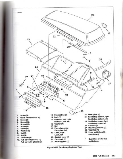

    Lucky,  that is held on with screws.  The square holes in the lid are pass thru holes, thats why not threaded.  I'm sure you lost the screws one at a time until the last one when the hinge finally came off.
    See the parts view for the lid it attached.
    There is a threaded backing plate (#22 on the picture) that slips between the rubber seal and the lid for the screws to thread in to.  If it is not still there I'm sorry to say it fell out and you'll have to get a new one.  The screws are very short so they just barely go thru the plate and not in to the seal.  I think they are 3/8" 6x32 screws (#5 in the picture).  I don't recommend using nuts in place of the bar because nuts may be a little fat and push the seal out making the bag not close correctly.
    You want to use LocTite on the screws.  I recommend taking the screws out on the other bag and adding LocTite too.  Since those screws only barely go into the bar they only need to back out a couple turns before they fall out.
    October 25, 2012 1:00 PM PDT
    Thanks Bailout. I see that now. I actually found the backing bar, it had fallen but wedged behind the latch.
