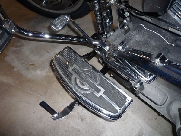

    Now I love my rear shifter, but I always hated the fact that it got in the way while riding and I couldn't move my foot back. I noticed though that when I shifted, because of the angle of my foot, I was actually hitting more of the shifter arm with my heel than the shifter peg.
    So here is what I did. It allows me to shirt just fine with my heel, but is out of the way for riding...

    November 11, 2009 5:23 AM PST
    VERY CREATIVE there Lucky!

    I like that rear shifter suggestion there Lucky!

    CarLow,
    I also added these Floorborad Spacers from SoftBrake which extend the floorboards out about 3/4".  That really allows you to put your entire boot squarly on the floorboard.  I recommend them for anyone who has a Harley touring model.

    Lucky, thanks for the suggestion on the rear shifter...modified mine last weekend and love it! Now I need to get the floorboard spacers.

    solid idea on the heel shifter lucky. i completely removed mine and made a spacer to fill the void, my last bike was a cruiser with floorboards, i just stood the shifter up and shifted with my heel over the top

    By the way Lucky. Got those floorboard spacers. It is amazing how much of a difference just 3/4" can make. That is all you need to get your foot fully on the floor board!
