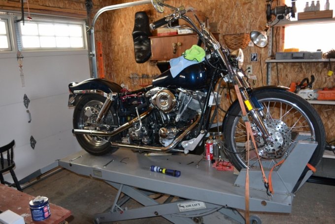

    New Handlebars:
    Extended cables and wiring.  Wiring was all done in RED and not color-coded so it took me some time to find the ones I needed spliced.  And of course I spliced them with red.  Didn't matter anyway as I didn't know what color they were suppose to be in the first place.  But I did manage to at least mark them for future references.  Other than doing some primary side cleaning  and chain inspection that's about all I got done.  Had to wait for the longer brake cable from the tree to the reservoir.  And of  course I had to read up on a so much stuff that I forgot over the years.  I did do a bit of cleaning and polishing but the bike is going to need a redo in that department. I got attacked by a couple of spiders while cleaning so it's pretty dirty.  A few of the chrome accessories were apparently cheap as some of the chrome was pitting and peeling.  Can't' have that.  I'm going to try my hand at that copper electro-plating on some parts and just paint others.
    You'll not see me doing any fabrication in the manner of AquaDave; mostly because I'm not "inclined to be" a mechanic so I'll not make more work for myself.    And, I'm not going overboard at all either.  I really just wanted to get rid of the drag bars but you know how that goes; first one thing then another.  Gotta lose that crank case breather. But she'll look fine when she comes off the lift.  How about that lift anyway.  What a blessing that find was.

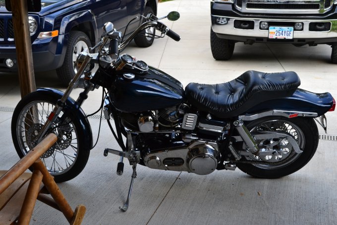

    So here we are with the latest update.  Blue Night is off the lift and all her wiring extensions are completed.  The source of the failed starter button was the starter relay and not the button.  Because all the wires are freakin' red it took some time to trace everything.  Plus I'm an electrically illiterate miscreant so, even with help, it took some time.   Didn't have to replace the starter relay however; the contacts were a bit sluggish so I just cleaned it up, sprayed some electrical wire dry and contact anti-corrosion stuff.  It's still a bit touchy and I may have to actually replace the relay one day but .....and here's the good part........two kicks and she fired right up.
    I did remove that sump breather; more of a novelty item than a useful addition really.  Would've been something that needed maintenance anyway.
    Took her down the road.  The clutch cable I got wasn't short like I thought it was going to be; I could make a right turn without any problems.  However, the extension of the front brake line from the triple tree to the master cylinder just isn't a good fit.  I don't know if it's the hydraulic fitting on the new line or what.  But brake fluid squirts right out of that hydraulic fitting.  It's just not seating properly for some reason.  Other than needing new tires I'm damn lucky the only problem there seems to be is that front brake assembly. Oh yeah, and the bleeder valve on the right front brake caliper won't hold a wrench.  That can be a problem.  Hate to break the damn thing by using vice grips but I'm sure I can get if off somehow.
    And so here are couple of pics with the new bars and the seat back on.  Oh yeah; I'm freaking excited about putting some tags on her real soon.

    Looks real clean Jimmy. What year Is that wide glide? That Lift IS a great deal!!. How did you get the lift?
    That sure is a long rod to the rear brake master cylinder.
    April 2, 2015 2:42 PM PDT
    panheadgeorge wrote...
    The year is 1978 and the wide glide front end is custom with machined aluminum spacers at the front axle, chrome tubes. The triple trees were also machined aluminum as were the forward controls.   The front end was originally a narrow glide.  As for the brake rod; the master cylinder probably could've been moved forward for a shorter rod but that would've meant a longer brake line to the rear thereby creating a longer fluid passage.  Didn't want to do that.
    The lift I got off of a buddy (Joe) of mine who had his own mc repair shop.  When his partner Bear was killed in an accident Joe just lost interest in the shop.  He and Bear were as close as two brothers could get. They bought, sold, and repaired all makes of bikes.  Anyway, he closed up shop, had two lifts to get rid of and I bought one of 'em.   It also has removeable side ramps/rails to accomodate 4 wheelers.  It's a cool lift.  Air pressure sure makes it easier to lift a bike that's for sure.
