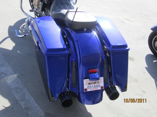

    Black9, Been thinking about exhaust on my '12 CVO Roadglide (Custom)...not wanting the fuel management system yet on it...yet...just wayyyy too quite.... Really like look of the stock exhaust on the CVO though... Any suggestions? Anyone?
  • February 7, 2012 11:32 AM PST
  • February 7, 2012 12:09 PM PST
    Wow the back end of that thing looks awesome too. Can't help ya, I just ordered some Rushes......lots of em out there, hard to choose.
  • February 7, 2012 2:11 PM PST
    What's wrong with what's on there? Pull the baffles, take the wrap of the baffles, then cut the baffles in half reinsert the baffles and you should be plenty rumbly and loud! ;-)
    Make sure when you cut the baffles in half that you make a note of where the fitting screw hole insert are so you don't cut them off that way you can put it back together without any problems. It's how I do it! :-)
