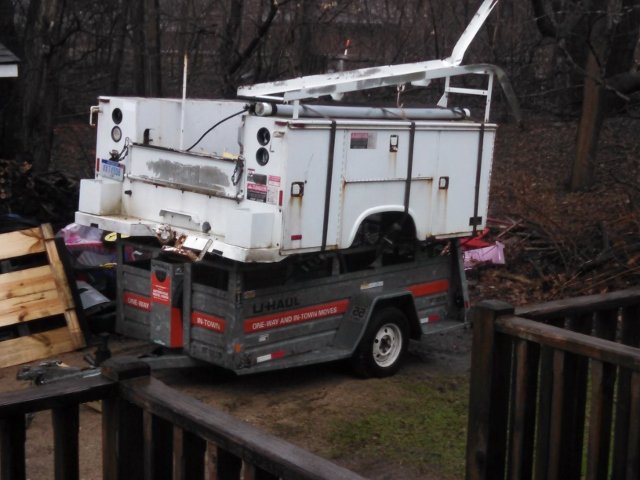

    I picked this up cheap near Christmas. Towed it home from Holland, MI. Every chance I get I have been fixing rust, welding   new metal, new LED lights etc
    Had to lift it up to pull the trailer out from under it.

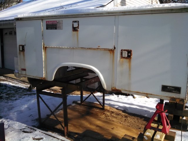

     Now it sits like this while I work on it.

    I could not work on it outside so I dragged it in the garage. I found a model number on the body. Then I re-checked the measurements and looked it up online. When I measured it at night in the snow, it was the right size. In reality, it is a 60" cab to axle body. Online shows this includes the 3" space between the cab and body.  My truck needs a 56" cab to axle body. For the price, I couldn't find what I needed. I had to decide to scrap it or make it work.
    So .......
    I cut 4" off the length of the body. Welded it back together.
    Still have to:
    Replace the pans at the bottom of the boxes.
    Replace rusted bottoms of the doors.
    Replaced all lighting with LED lights.
    Replace all door handles with stainless handles.
    Plan on painting it a darker color instead of trying to match the paint.
    Replace bottom door skins and cab corners.
    Darker paint will continue on cab at bottom and over front fender flares.

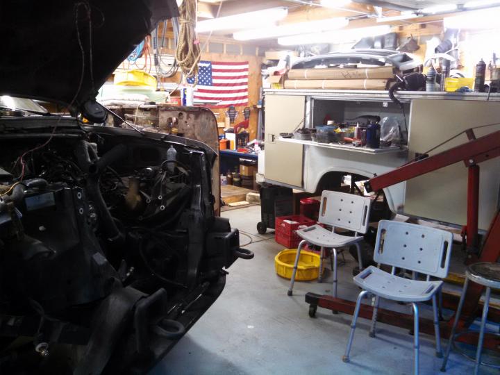

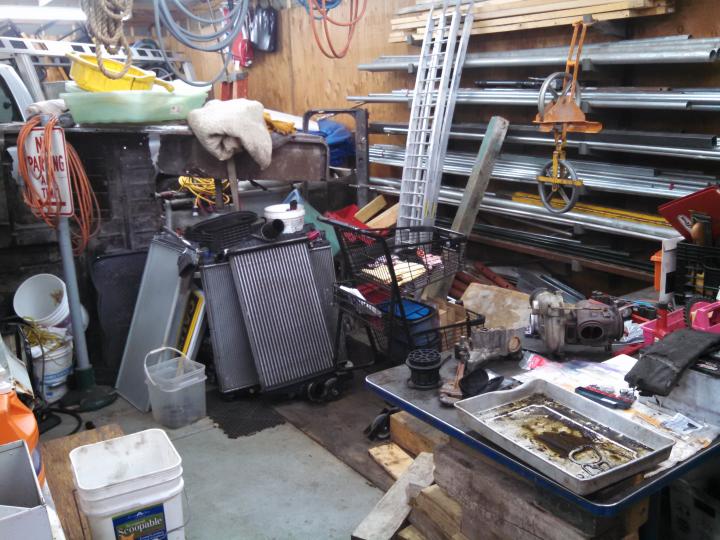

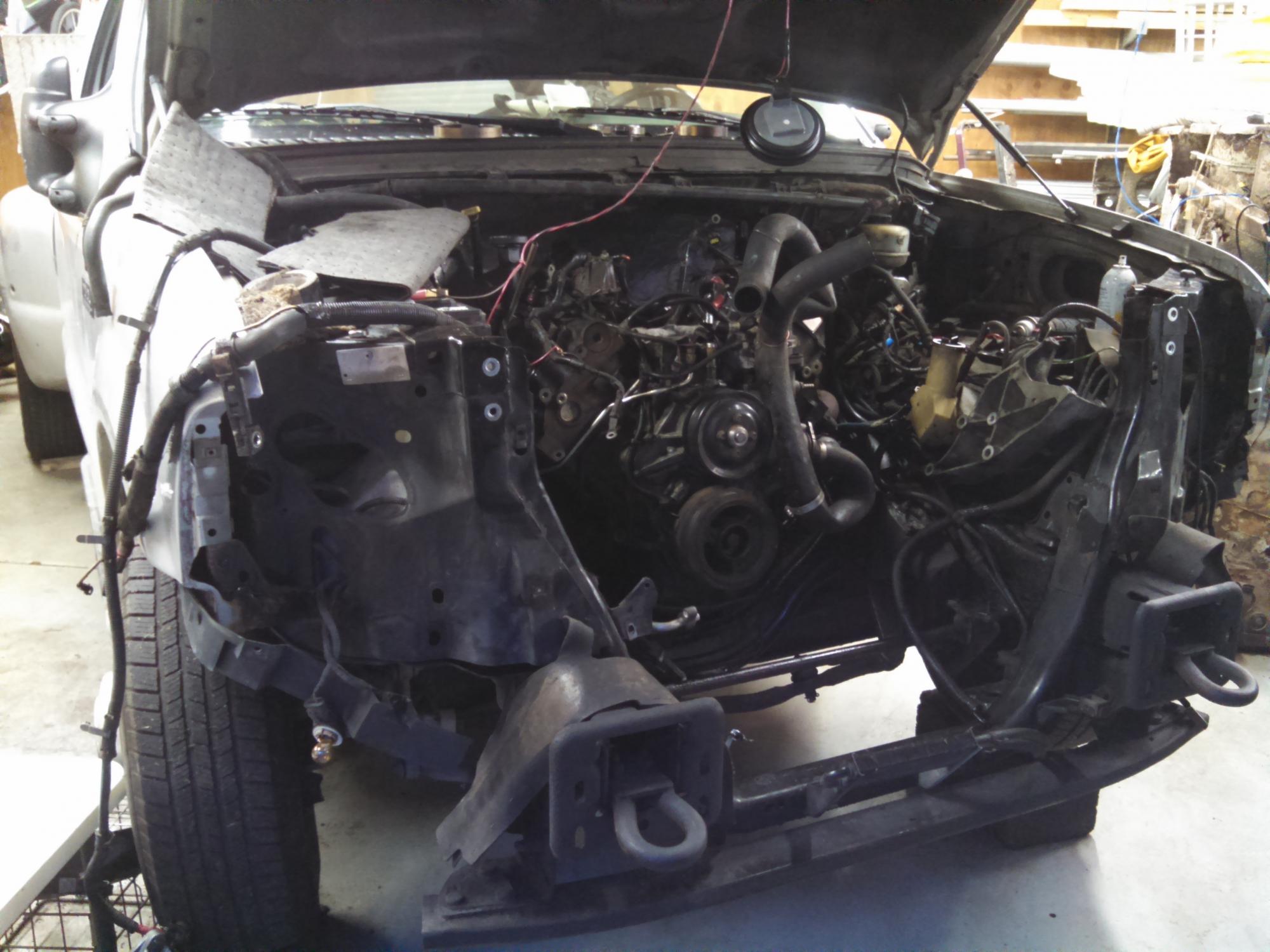

    Had to stop work on the bed. With help of a diesel tech, we removed motor to change the oil pan and fix leaks. Motor is back in the frame. Put new doors on the truck body. Next project is a 74 CJ6. You can see the body on it's side behind the radiators.

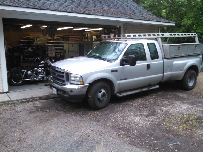

    Finally put the truck bed on the truck.

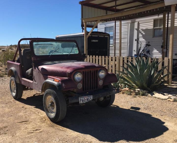

    Jeep, did you say Jeep? Cool! I recently picked up this '86 CJ7. It sat in the desert here for over three years. Needs lots of little things and with it's solid frame, very good body, and good running gear it will be a fun project. With a little coaxing, I was able to start it and drive it home.
