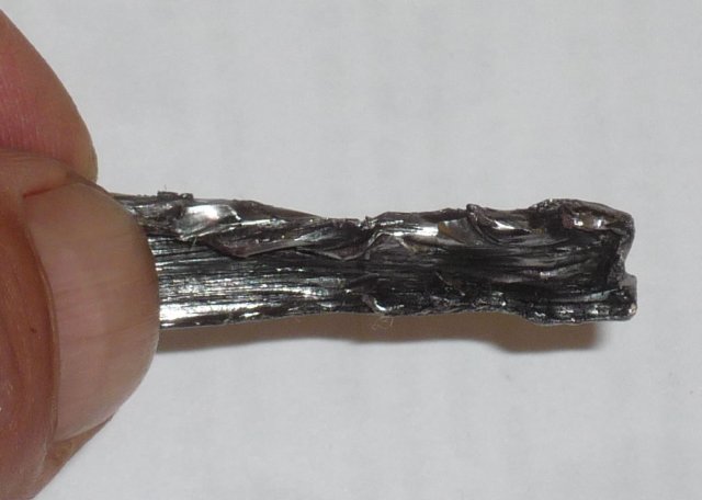

    I was riding up to redwoodand after a stop as I was getting on the freeway a sound came from the primary that sounded like when you used to put playing cards in the spokes of your bicycle.  I pulled over and it would faster as I rev'd the engine - then the noise went away.  The next morning highrisk, harleyman and I pulled the primary cover (my apologies to the Garberville Inn for the mess in the parking lot) and found the piece of metal shown below in the bottom of the primary case.
    The piece is about 1" long, 1/2" wide, 1/8" thick, and very hard steel.  We inspected everything we could see in the primary - without pulling the clutch or gears and could find nowhere it could have come from.  As you know there ain't much inside the primary case except the main gears, chain, clutch and auto chain adjuster... and no of those appeared to have anything missing.
    The bike is a 2007 Road King (FLHR), and as far as I know the primary cover has not been off since new... only the derby cover.
    See if you can identify this piece????
    • 19049 posts
    June 14, 2011 7:52 AM PDT
    I don't recognize it, hopefully it was something left in at assembly and not something coming apart. Obviously a GOOD THOROUGH inspection is in order.

  • June 15, 2011 4:08 PM PDT
    LOL yeah it is awfully big to be from the clutch hub (but I would pull the hub and check anyway) no key way chucks in the newer cruise drive tranny models.

    • 33 posts
    June 16, 2011 2:24 AM PDT
    If I had to guess, and only a guess, it's part of the chain tensioner. As in you wore off the pad and it grabbed the whole plate and yarded it off. but just a guess.

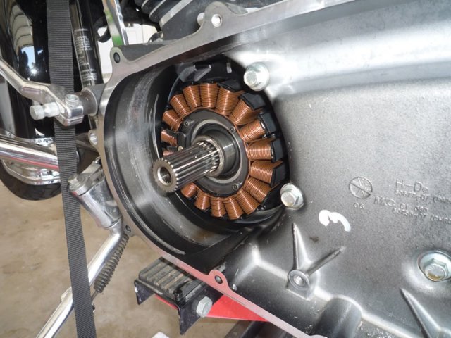

    June 18, 2011 10:11 AM PDT
    I FOUND IT!!!!!
    Never would have guessed this one... it was a piece of the outer housing on the rotor!!!
    As you can see it did a number on the inside of the primary case too!
    The only thing is the piece I found is about 1 1/2" and the missing piece is about 4"???  Guessing it either turned to shavings, which I found a lot of, or fell out when I first opened the primary on the road and I didn't see it.

    • 16840 posts
    June 18, 2011 3:43 PM PDT
    Good thing it wasn't one of the old tin inner primary covers, it would have cut through it.
    June 18, 2011 5:05 PM PDT
    Yep, guess I'm just Lucky (I say that a lot don't I)
    Of course the rotors hardly ever go bad so no one has one. Now I got to leave it sitting apart until next week... and the weather is beautiful!

    • 19049 posts
    June 19, 2011 2:09 AM PDT
    Glad the mystery is solved. Rare it is to have the rotor fail. Are you thinking of replacing the stator too. Mine shorted at 62K, and since you already have it apart...
    June 19, 2011 3:02 AM PDT
    I thought about it and was concerned about maybe some of the metal chaffing the wires, but after a real good inspection it looks to be ok.
