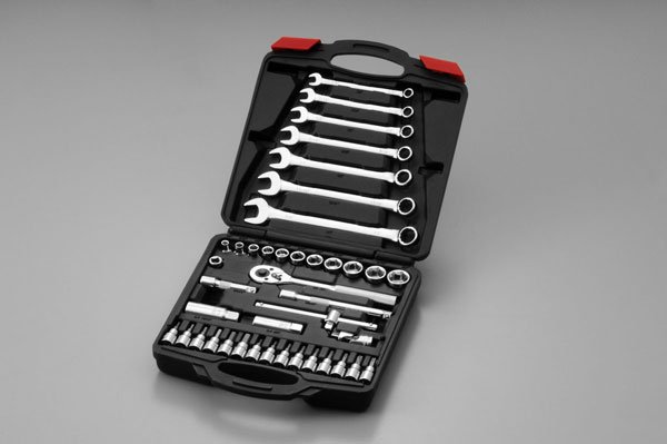

    Small list from tool set that was design for Harley bikes I hope it helps.
    ●Ratchet steering wheel
    ●Extension bar 75/150mm
    ●Universal joint
    ●Sliding driver
    ●Torque socket T10 .15.20.25.27.30.40.45.50
    ●Heck's socket 1/8, 9/64, 5/32, 3/16, 7/32, quarter, 5/16, 3/8
    ●Plug socket 13/16(21mm), 5/8(16mm)
    ●Socket wrench 7/8, 13/16, three-quarters, 11/16, 5/8, 9/16
    ●Socket wrench (12 angles) half, 7/16, 3/8, 5/16, quarter .10mm
    ●Combination wrench 3/8, 7/16, half, 9/16, 5/8, 11/16, three-quarters
  • May 1, 2013 2:50 AM PDT
    Ratchet steering wheel? Is that one of those little tiny ratchets that is basically head portion of a ratchet? And by sliding driver are you talking about a T-bar?

    This is actually a nice kit here if you add a few more sockets to it...
    http://www.beza.biz/windzone/catalog/ek1hd style="font-size: larger;">
