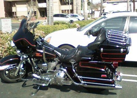

    Hello group...I ride a recently-purchased '90 FLHTC bagger.  she has 32K on the clock and runs like a champ.  The previous owner added several lights to the rear of the bike that active as running/brake lights, and I am noticing that when I apply my brakes (front and/or rear), the voltmeter will drop substantially from 13-14 v to 8-9 v.  Additionally, I have noticed a pegging of the voltmeter needle at 0 when I spool up the starter.  This all came about about 2 weeks ago when i tried to start the scoot after sitting for about a week, and got NO action on the starter.  I put her on an overnight trickle charge, and the next day she started just fine.  There is a split-second hesitation when I depress the starter button before she turns over, and this is when I've noticed the meter peg to zero.
    I am thinking that there should be a relay in the lighting system to relieve the load of the extra lights, and am at a loss on the starter situation.  Any guidance on either or both issues would be appreciated.
