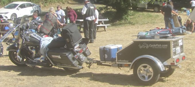

    first time buying a pull behind trailer for my Harley. anybody have any thoughts on swivel hitches.
    are they better or not?

    My personal opinion is they are a "gimick" item that is not necessary and even creates and additional fail point.
    I have over 10,000 miles on my trailer without one and rides just fine.  And though not a planned test, I know for a fact there is enough swivel on the basic hitch ball to lay my Road King down on the engine guard without twisting or damaging the hitch.  Besides I would hope you wouldn't be going through twisties and leaning that far over with your trailer behind you.
    Just make sure you grease the ball with a good quality grease, your latch is adjusted properly (about 1/16" inche of play when latched on the ball) and you have 30 to 35 lbs tongue weight when loaded and you will have plenty of swivel on the ball.
    Note: I carry a fish scale with me to check tongue weight befor I hitch the trailer up.  Just hook it in the ball cup and adjust the load front to back to insure 30-35 lbs.
