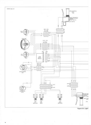

    Here's a schematic for my FXR if it will help

    Yep, that's the same setup for my Fxr in case you can't read the schematic

    http://i50.servimg.com/u/f50/11/00/68/87/1998-110.jpg />
    try this diagram..see if this helps
